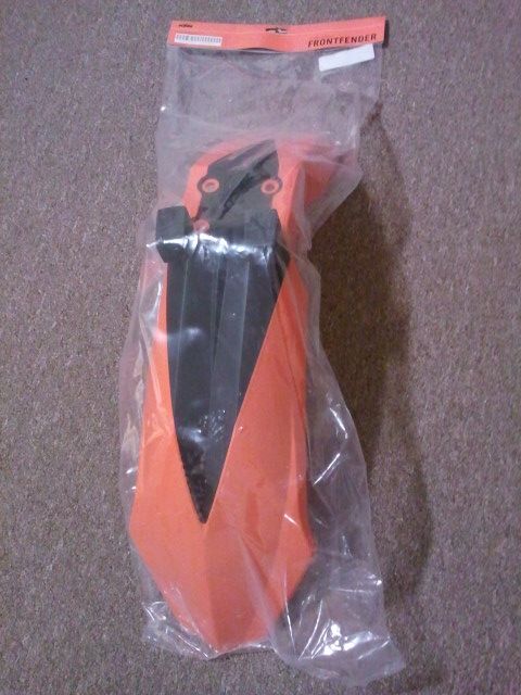

SMR front fender

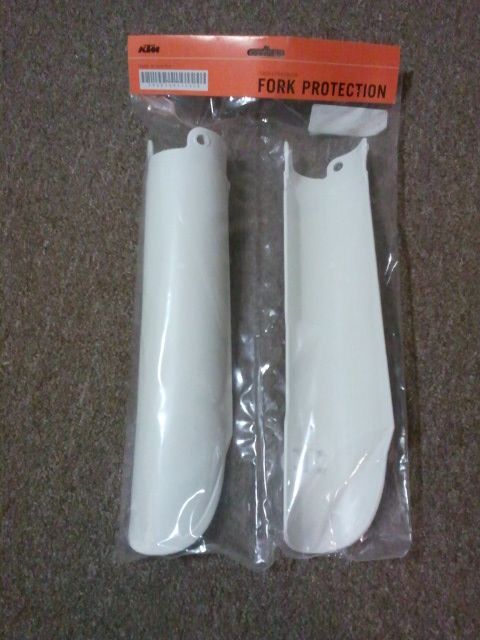

SMR fork guards. Hope they fit

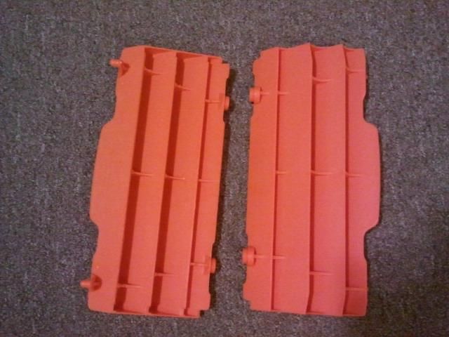

Some KTM orange radiator protectors

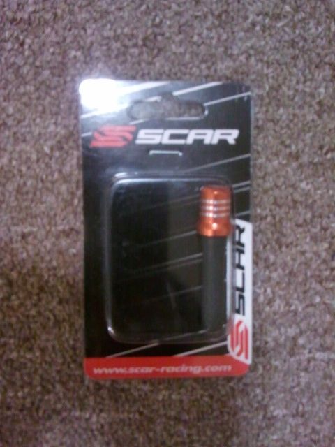

Scar gas cap vent. Looks good, though I'm still tempted to order the one from KTM

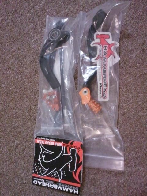

Hammerhead Desings brake and shift pedals. I went with the CNC shift lever, but the forged brake lever. I was real impressed with the strength of the forged brake lever on my CR500AF motocross build.

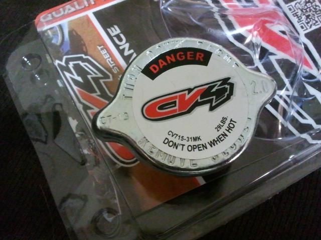

CV4 31 Lb. (?) radiator cap
Here's the interesting part. 31 Lb.
...but wait...29 Lb.! I want my 2 extra Lbs, haha.

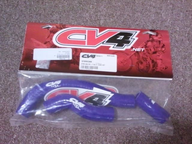

and some blue CV4 radiator hoses.

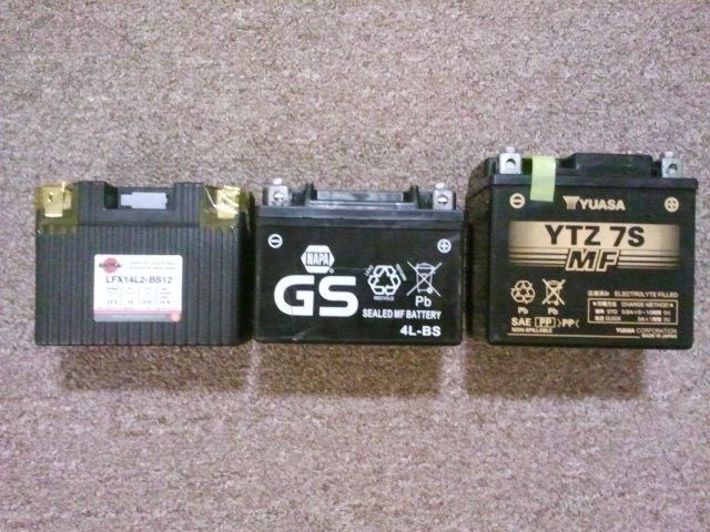

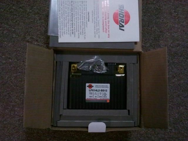

New Shorai battery. Currently I'm using both the Lithium batteries from Ballistic and Antigravity and I've been EXTREMELY happy with both. This time around, thought I'd try out the Shorai because the case size and shape seems closest to the original battery.
LFX14L2-BS12. 210 CCA @ 1.46 Lbs.
versus the original (YTX)4L-BS 50 CCA @ 2.9 Lbs.,
the next size up with the larger battery box (YTX)5L-BS 70 CCA @ 3.5 Lbs. and
the YTZ7S, 130 CCA @ 4.6Lbs
Seems like money well spent to me.
Here it is next to the 4L-BS that came out of it and the YTZ7S that came out of the Husky.

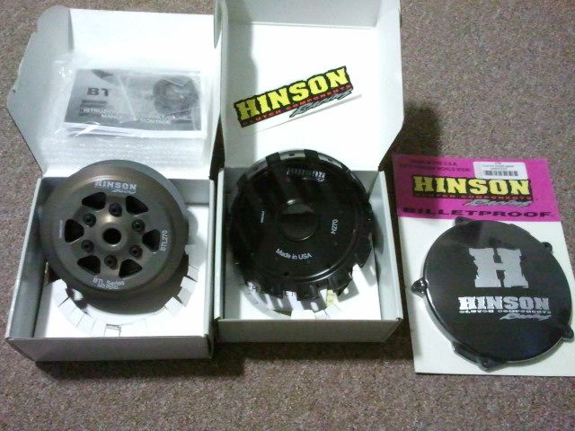

Biggest purchase for the project so far.
Hinson BTL Slipper Clutch, Hinson Clutch Basket, and Hinson Clutch Cover. Have new clutch plates/ springs awaiting also.

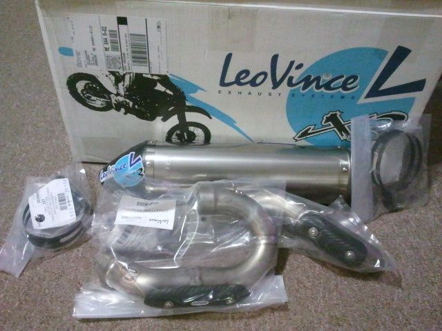

Got new Leo Vince Exhaust. Just went with the SS header, Ti can/ Carbon end cap combo. $300 shipped. Naturally I wanted the Ti header cuz they look so purdy after some heat cycles and I was leaning towards Akrapovic or FMF, but I saved hundreds $$ going with this. If I change my mind though, the Leo will be going up for sale.

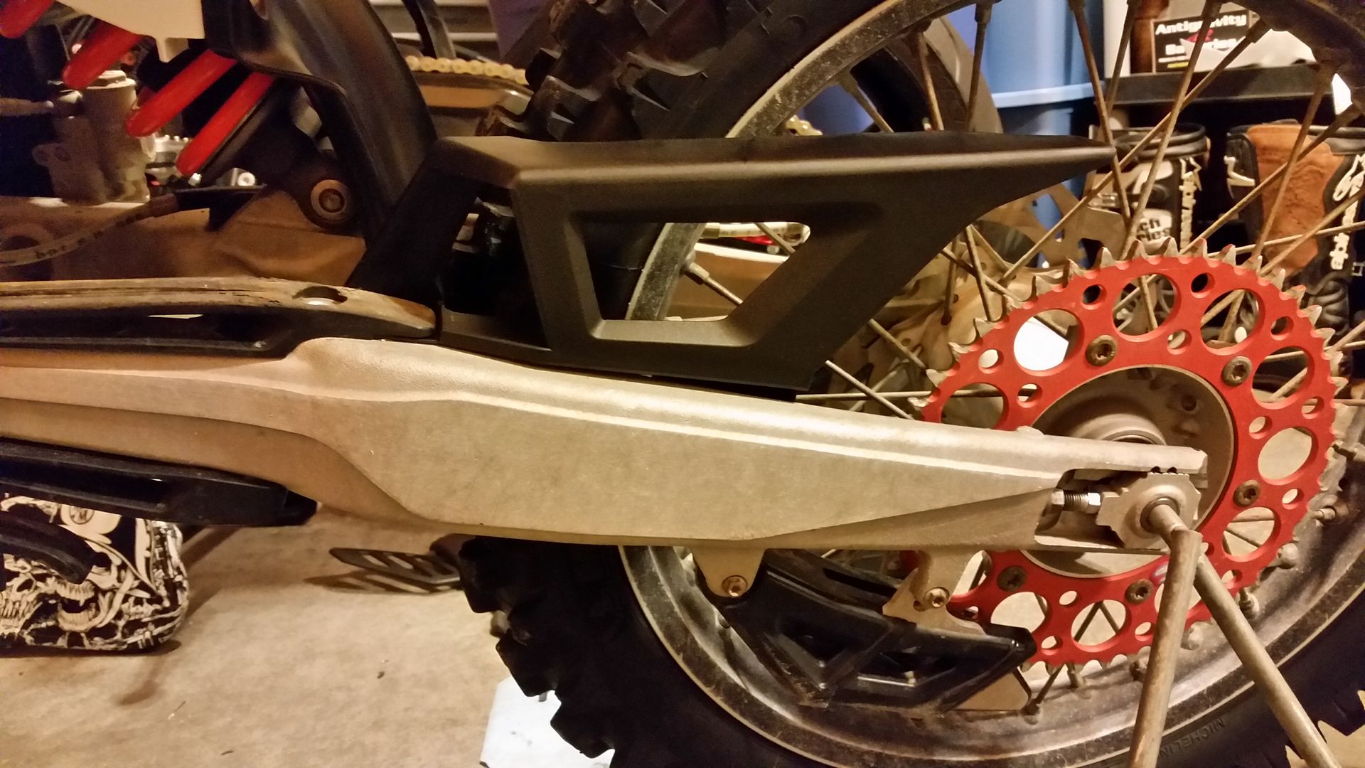

Plan on powdercoating frame and swingarm. I need some input on a chain guide and skid plate, with pix preferably. I would like to do all the fab work before the powdercoating, i.e. any required welding mounts etc. I will need a upper chain guide for an inspection sticker down the road. Plan is dual purpose with bike- track and street, that is :)
What works, what doesn't? Put on a 530 EXC chain guard? or perhaps one from a 2014 500 EXC? Maybe it uses the same one? I haven't looked yet. How about one off a 690 SMC? Those cover more area, but are in excess of what I need for a sticker.
Also I would like a quick release skid plate, but I haven't found anything for the 505 SXF yet? Has anybody used one off another bike that fits or would with a little work or maybe found one that is available? Leaning towards plastic rather than carbon, as it's not likely to stay pretty and glossy.
#31 ·
The 500 EXC chain guard bolts right on. :D Possible I may have to notch it to clear a 160 tire though. That's fine, I just wanted something for down the road so I can put it on the street.

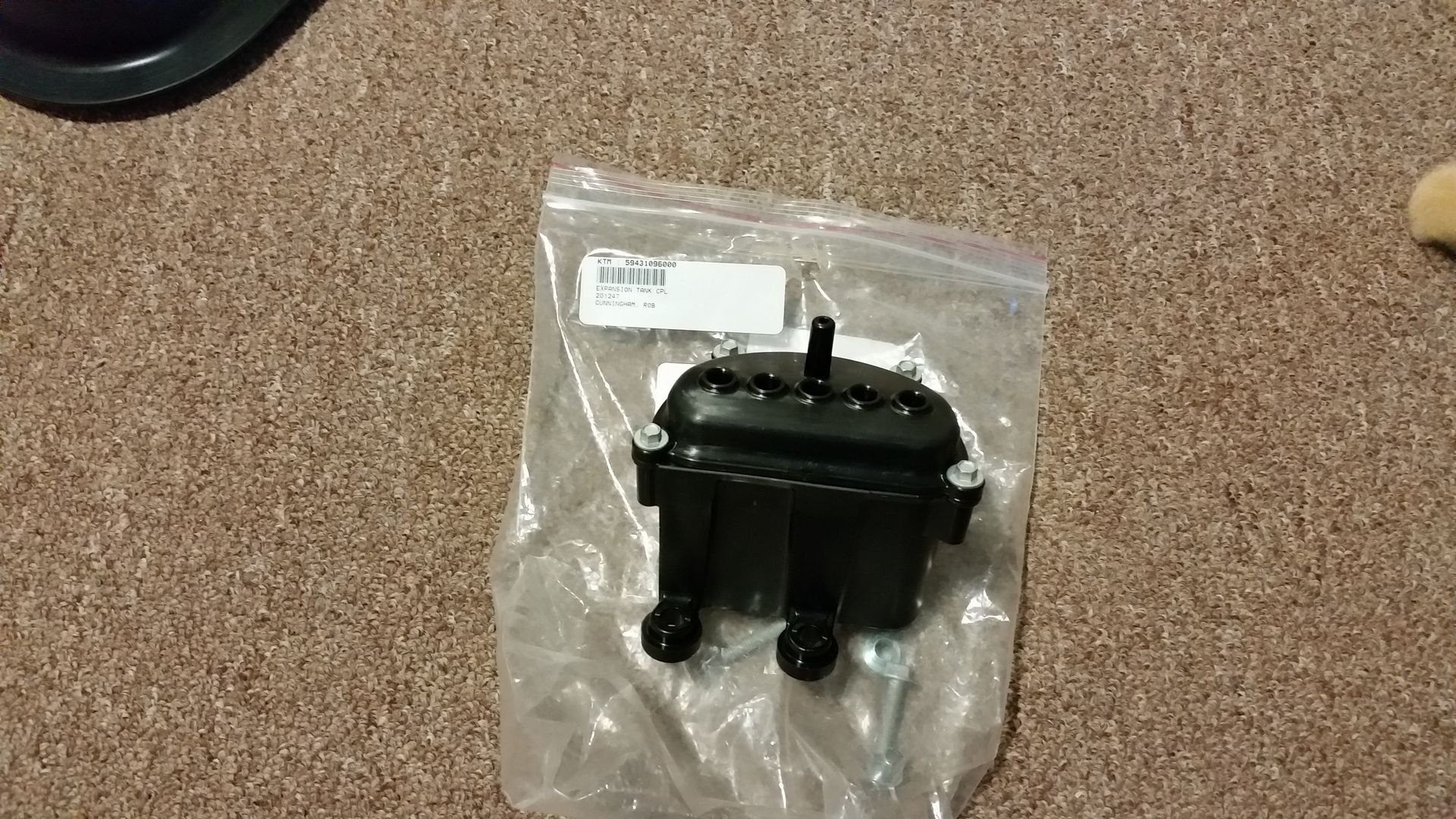

KTM catch can

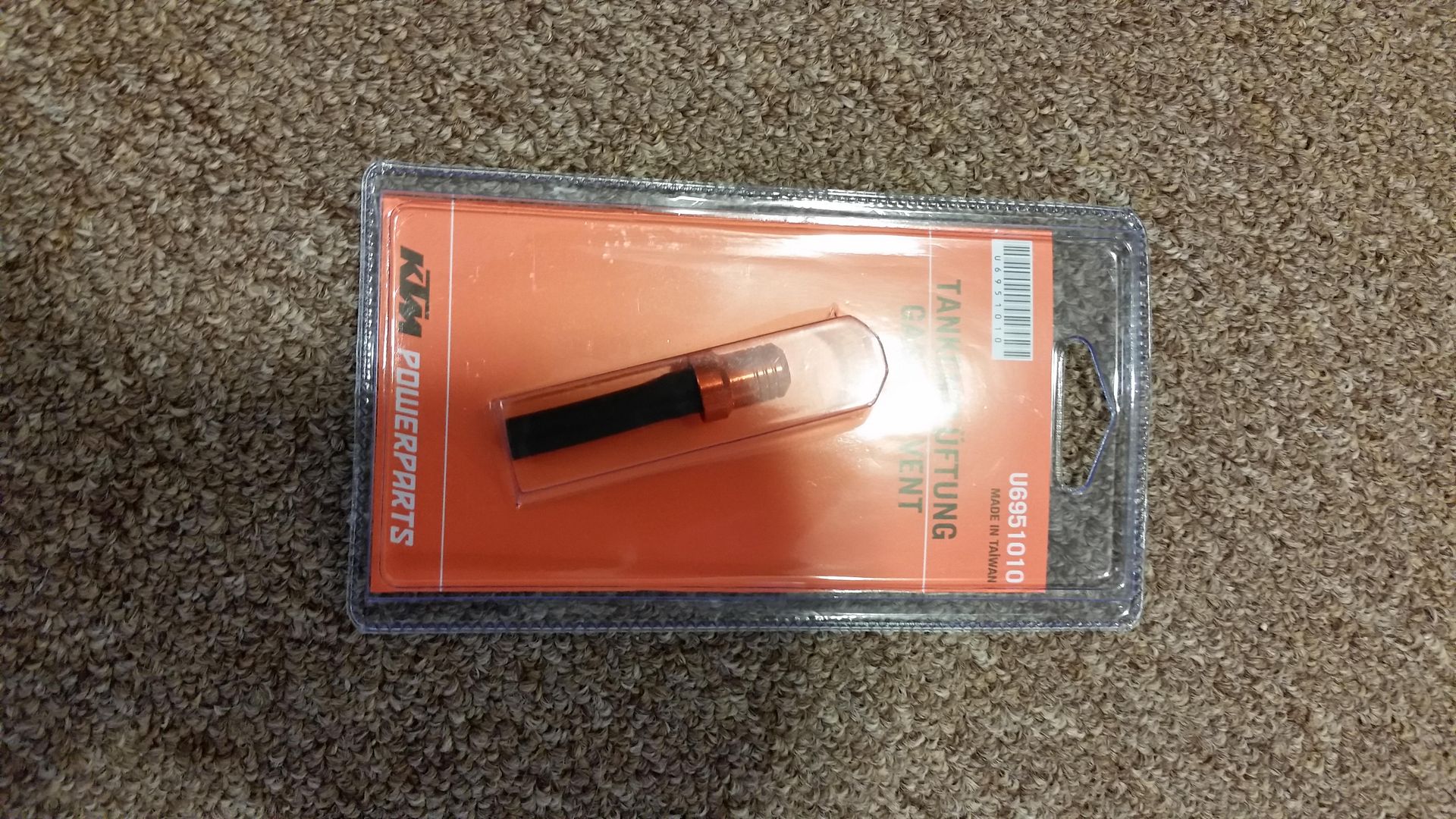

I did end up getting the KTM gas cap vent
