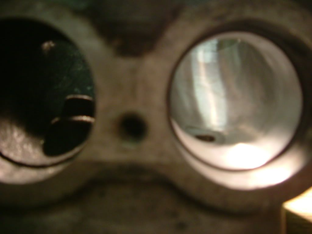

Bored and plated standard barrel out to 97mm and used a Vertex high comp piston.
Changed the cams to hot cams.
Ported the cylinder and had a three angle cut on the valves and seats.
Replaced the carb with a 41mm
