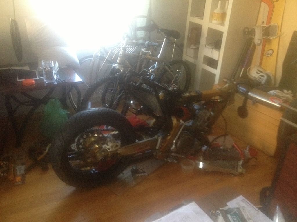

Anyway, I now sit here typing this with one hand and drinking from a straw overlooking whats left of my bike after my friends carried it into the living room of my apartment. Could really use some help with a few things from you guys as I had purchased the bike already SMd.

After One Handed Tear Down
Everything from the front is gone except the hub, tire, and top part of the steering damper.

So my plan is a crf swap on the front which I got the gist of. Going to do it with a bearing swap since my steering stem snapped in the crash. A couple of questions I have is on the frame. It looks like part of the front end gouged the frame in the front deep enough to let oil out and the bottom of the steering neck where the stem ripped out is pretty chewed up (might be workable with new races). Also gambling that the frame is still straight. Hoping to clean it up anodized gold again but could do powder coat. Is it possible with this old frame or just get a new one? I have one sourced for $460 shipped. Will changing the frame affect street legal status?
Sorry about the pictures. Best I could get with left hand.
