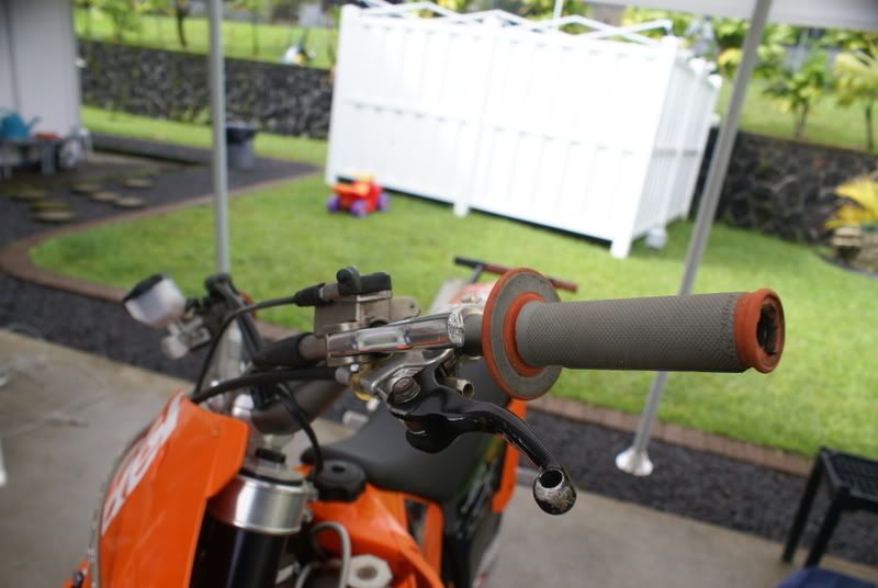

Nice bike man. I have almost eh exact same bike, lol. When I bought my 426 it even had blue grips and the exact same graphics!!! Now if I could ever find the time ot finish my subframe..... Until then the pegs and footbar are alright! As for the handbrake idea, do what I did. I also already did the GPtech rear handbrake setup so if you need any help just let me know. I run an F4i rear master cylinder (cut down the rod) with a Gptech adapter and goodridge buildaline... sound familiar? For the front master I got a shindy one and it works PERFECTLY. Lots of power. One thing I ran into though.... Get a stainless rear line because upgrading the rear master and adding that front will make that OEM line flex BAD!!!!
