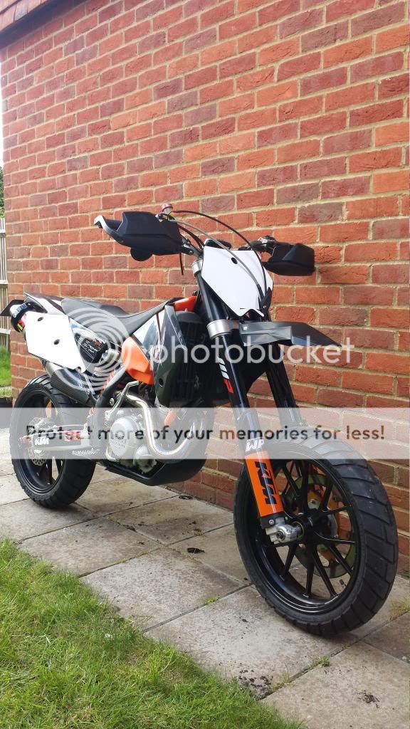

My 540 SXS/ SMR
It started out as a 560 SMR but dropped a valve; smashed the head and bent the rod so the previous owner replaced the motor with a 540 SXS engine. The mods are as follows:
2008 subframe and bodywork
GDS triple clamps
Factory 2 stage ignition
Beringer radial m/c, caliper and disc
Excel rims on KTM polished hubs (16.5 front)
2 piece clutch cover
Titanium rear spring
Remote hot start
Full ti akra
JD jetting kit
KTM slipper
Dev Tech swingarm
Still to go on:
Works style numberboard
Graphics
K&N
Ti footpegs
Stepped seat
Carbon tank protectors
Chain :rolleyes:
Carbon end can
New handguards
I'll bang some more pics up when it's done.

It's just about done now, took it out for the 1st time a couple of weeks ago and it flies.
Still need to powdercoat the frame, not sure whether to do the swingarm at the same time :hmmm:
