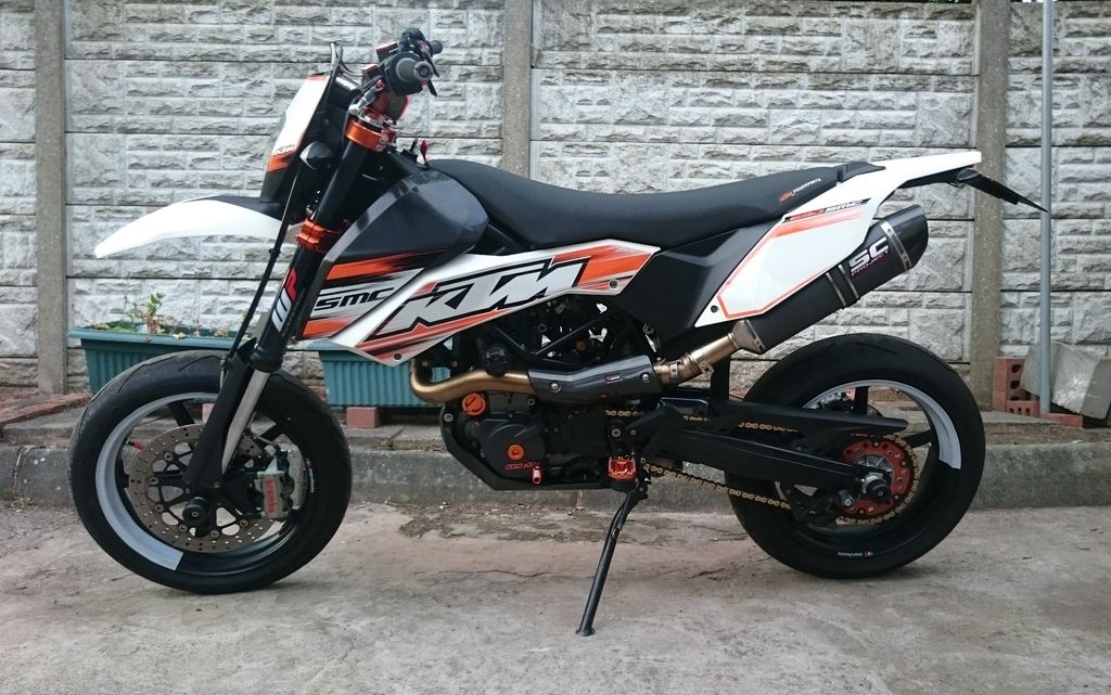

My bike one year ago when I bought it:
As it sits today:
Nice bike Yoghurt. Has that exhaust been modified. I just bought a low mileage ( 9000 Km ) 2006 640 SM.
It has tiny but plugs in the end pipes and sounds like my granny's scooter.
:headshake
Sorry did not look properly, I now see that its aftermarket pipes.
12 Posts
How come your hand guards and levers point towards the floor so much?
I think it just looks like this because of the pic and because the handlebar is turned to the same side as the side stand. Look at this pic where the handlebar is straight
And i will leave this pic so you can see how it was when i bought it
I think it now looks waaaaay better :D
