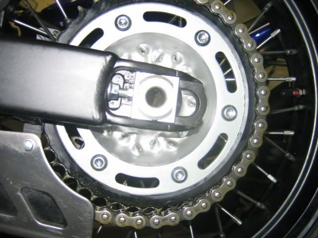

got a new wrx with 90 miles on it so far live the bike but noticed something weird today not sure because never had anything except sportbikes
the chain rests weird on the top of the sprocket i measured the slack it seems to be ok
when you back the bike up the chain now rests weird on the bottom of the sprocket
any ideas does my chain need tighting or is something else wrong thanks

you need to adjust ASAP. stock specs are wrong, yamaha issued a tsb on this,
Check the alignment of the wheel to the bike. It appears to me that the angle is incorrect and it is pulling the chain off the sprocket.
442 Posts
I agree. The short time my original was on it never sat up like that..weird. Also w/ my stock stuff the block/axle was further back in the swing arm. AFTER I had to tighten the chain up ?? Sure slack is not too much?
200 Posts
Look at how the chain links line up to the sprocket teeth where the chain appears to be coming off. The chain just isn't fully seated yet because that plastic piece on the sprocket isn't worn in yet. Yamaha issued a bulletin on it. Ride it more, adjust the chain, and all will be fine.

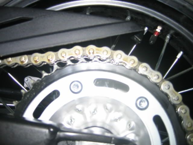

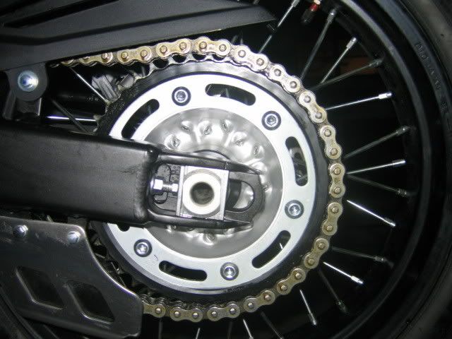

ok so i stoped by dealership with my chain tightened and looking much better, techs said i was a little tight by 5mm but ok if i was happy with it ride it so i now have 2 more days of riding it and stop for gas tonight and notice the chain is sitting just like above but no quite as bad i quickly check the tension seems ok so i now push the chain onto the sprocket the way i should rest and check tension again now it seems to loose is it possible that the chain is streaching this much in such a short time ???? not quite sure what to do next????
