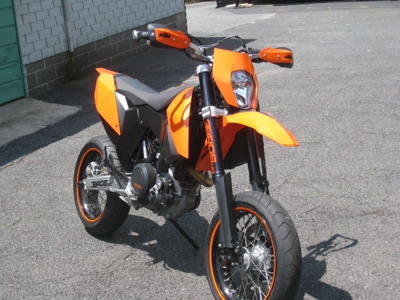

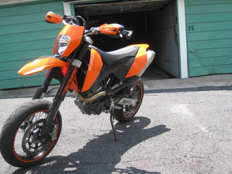

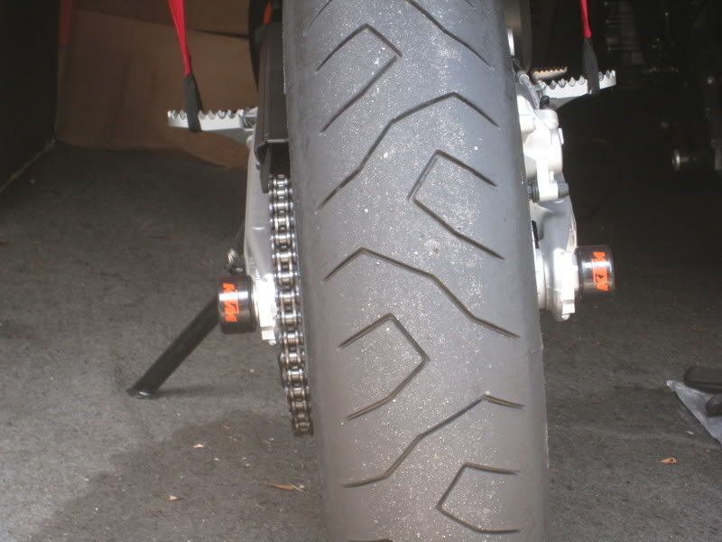

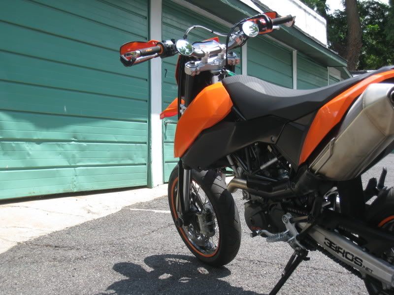

I just did a few more mods to the bike nothing major and also fitted the bike with a 15 tooth front sproket! I did a 15 minute ride around town (the bike was on engine setting 3) and it's amazing how fast and power this bike is now! I had a smile from start to finish!!! :D :bike: The bike should have came stock with a 15T front sprocket...wheelies are alot easier now and it moves up to higher speeds so much faster. Their is so much power now in every gear. I'm loving this bike now and suggest that everyone do this mod!!! I will be giving a update once I ride the bike with the engine setting to 2. I should have the euro brake light coming this week and will update the pics too! I'm dying for the black enduro skid plate to become available! :bowdown:

Yea, I'd be interested in trying a 15T- Mine is just so great on the freeway, I would hate to loose that top end.
I put on the 15 tooth also, and it still has plenty of top end. Mine did 110 tapped, and 70 mph is around 5100 RPM. You definitely grab gears faster now.........lol. I ended up the the SunStar sprocket, it seems to be a nice lightweight piece, about 1/2 the weight of the stocker, not that it's a ton of weight to begin with.

The mirrors are from dual star and the sprocket I got it from Munn racing website. I just called and asked for the 690 smc 15t sprocket. Make sure they send you the one that is damped. I will be getting a full exhaust either from fmf or leo vince once they are available...can't justify spending over $2,000 for a Akra single full exhaust system. I will be adding a lot more to stuff to the bike once they become available! I'm planing on added alot more decals to the plastics. I did that to one sport bike I had and loved it...so I will be doing to this bike also. I will be fully modding this bike out from the inside out...once more parts are available!!
