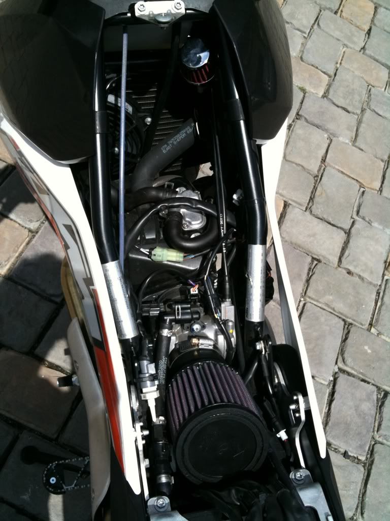

Here is my setup. I had it dynoed with tuneboy. with the longer air intake i get more mid range power. i dynoed mine with the stock air boxeith the lid off and this setup. we saw a nice of difference in mid range power with this setup. i wrapped the bottom of the heat sheild with DEI gold tape. i think hp was around 62. not bad just for exhaust and air box mod. oh yea i am running an akra pipe with no baffle. i am thinkingabout trying a 4inch filter though

That looks awesome terra!! What's thebdetails on the pipe you got there? Like length and pipe bend angle? And the internal diameter
And what did you do wit the maf??
1,496 Posts
Looks as the MAF is installed on the underside of the metal bell tube. How about ziptie the MAF directly to the pod filter. Even better, drill a small hole in the rubber sleeve on the pod housing,insert the probe,no pun intended:bannana: and secure it with zipties.

Hunk I'm gonna do a dyne test on the two options.... I'm gonna sink it into the pods rubber hose and leave it where it is and see what's better... I'm sure it'll run better with it inside it as itll register more air going in and add more fuel thus uppin the power..... Hopefully? Wadda ya think ELRWFO?
1,496 Posts
Already popped mine in the rubber intake sleeve. But not racing for two more weeks:[
