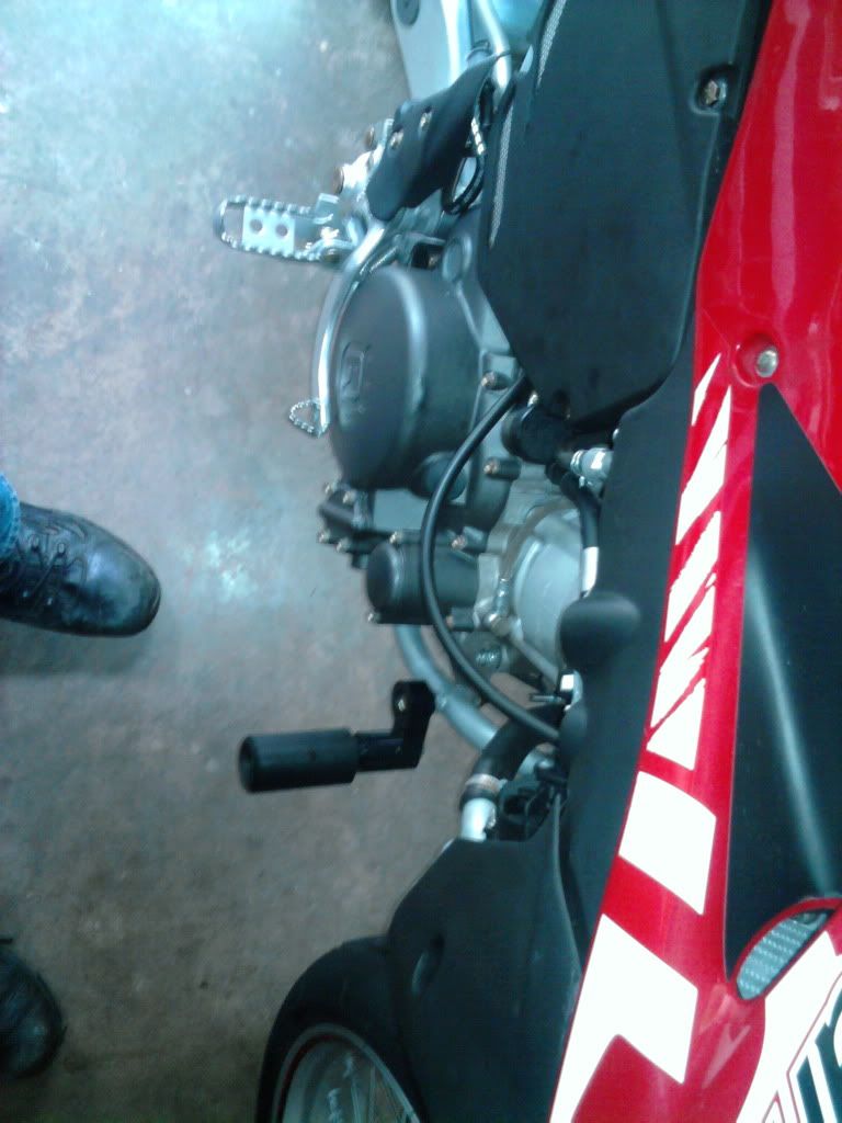

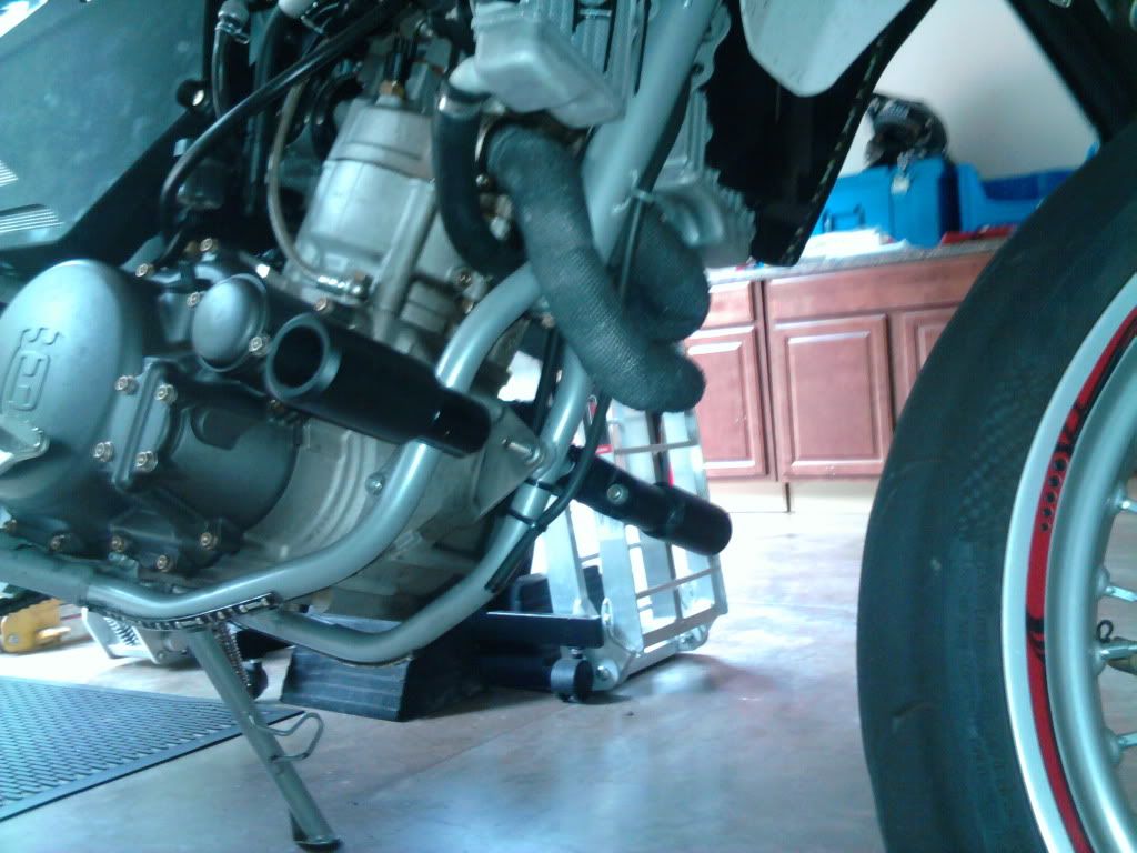

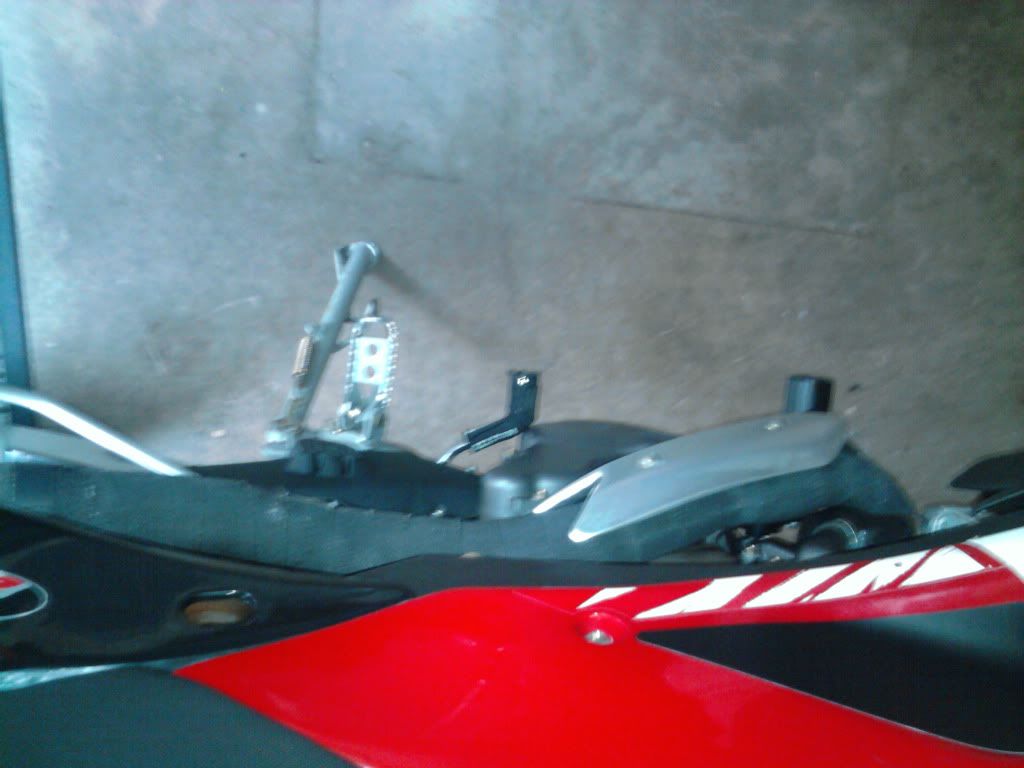

Along with my front and rear axle sliders, and muffler slider, i went threw my random assortment of sport bike sliders and made something fit.
That should help anyone trying to do this, but doesn't want to purchase a thousand different slider sets to see what will work... :thumbup:
444 Posts
Sport bike frames are much beefier cast aluminum spars. I'd be afraid even a low speed get off with your set up would bend the shit out of your Husky's frame. I'd think axle sliders and some 7602 Racing billet engine case covers would be better protection. Having posted this I see yours is a 610 and they don't make case covers for this model. What I would suggest is running a solid bolt all the way through if possible for the two sliders attached to the frame to help absorb any impact if you dropped it.

Could this work if you ran a rod between the two and maybe some type of tubing over the threaded rod between the two tabs inside the frame would that make it rigid enough to work?
1,805 Posts
You don't want anything that will dig into the dirt if you low side, and a threaded rod will bend like a paperclip, along with the frame.
I've got a Hyde polymer plate, it keeps the cases off the ground without digging in and making a slide more violent than it already is.
Between that, handguards, axle sliders and peg sliders, nothing important has ever touched the ground, despite my best efforts... :anim_peep:
