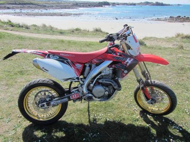

Hi guys I brought a CRF 450X a few months back. The headlight is better than my old KTM 125 it is still pretty rubbish! I understand that I cannot run a HID from the battery as the charging power to the battery is something like 10w if I can remember correctly, and I can't just connect it to the headlight wires as it runs on AC. So could I purchase another rectifier then send the power from the headlight to the battery so the battery does not run down and it can also supply the large start up current for the HID or is this a load of rubbish?!
Cheers
James
