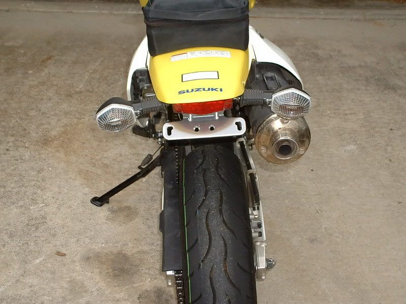

If you still have the stock rear fender extension? The Edge taillight is a nice addition.You can get it from www.wheelingcyclesupply just ask for Forrest. This tailight assembly is easy to install and cleans up the rear...

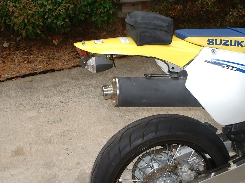

I have only seen kits to lower the rear, not raise it. The suspension links below the shock is where that is done. Take a look at yours and see if maybe yours were replaced with the lowering links. The lowering links I have seen (check ebay, there is usually at least one set on there) look like they are cut from billet where as the stock links look cast.
I think the big ass gas tank makes them look too low in the rear
