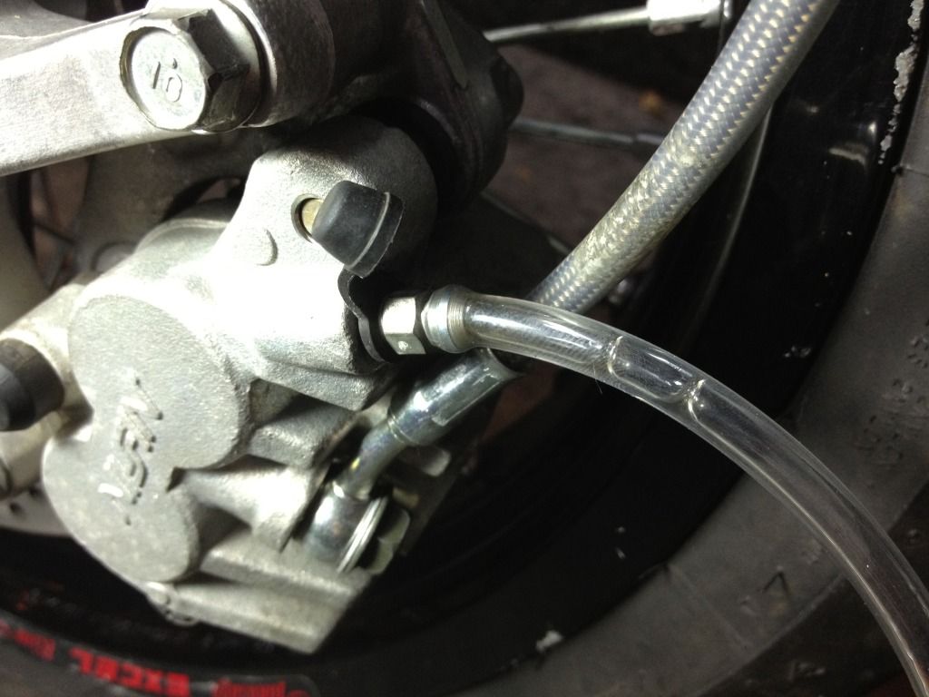

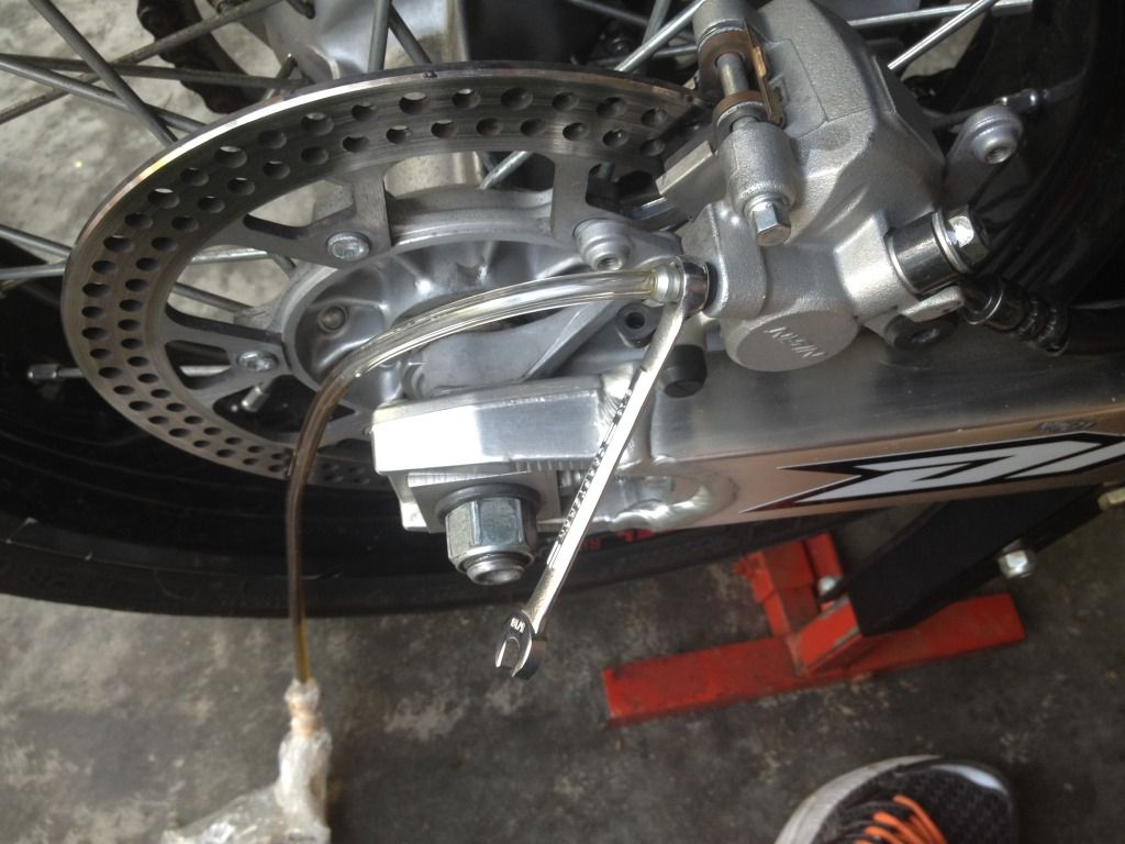

Buy 10' of .25" clear rubber tubing from Home Depot. It will cost $2.25. Wiggle this on over the nipple, and run it into the beer bottle you just emptied.
Or, run it into a plastic baggie. I used a turkey bag. Then loosen the nipple and pump the lever to get all the fluid out. ...yeah. Calling Dr. Freud.

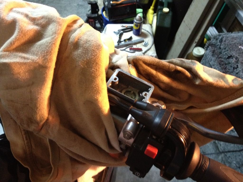

- DOT4 will mess your paint up. So will brake cleaner. Wrap a rag like this, because that POS Prestone DOT4 bottle was designed by an idiot
who could not design a drip-proof bottle.

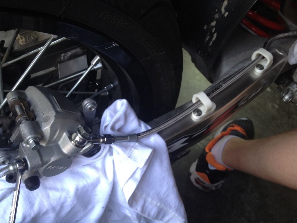

Same thing. Rags down, cap off, hose on nipple, open nipple, work the lever, get the old stuff out, remove brake line.
The back went MUCH faster and easier than the front. Galfer makes a great vid on YouTube that shows how to do it.
Worked like a charm!

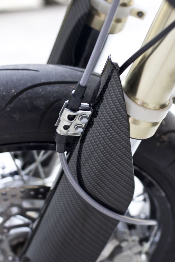

Teaser shot of install below...
check over in the Pic forum for DRZ400SM - Mod 4.5--the carbon fiber graphics on the plastics for the DRZ.
