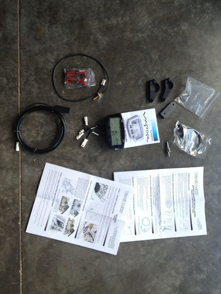

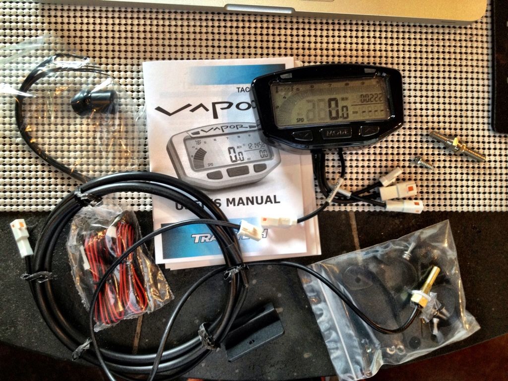

I got the 752-301 kit, which is for the DRZ, and is the "stealth" or black kit.
The Tach/Power wires are identical--but the female plugs on the unit itself are labeled.
From what I understand, depending on which kit you get this may not be the case--the tach and power wires may be totally different.
Quick thoughts:
Instructions: They're good. I'm a techie, not a mechie, so these were great.
Also, they give multiple ways of doing things like the tach and speedo.
Built in contingency plans? Sweet!

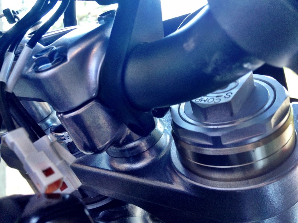

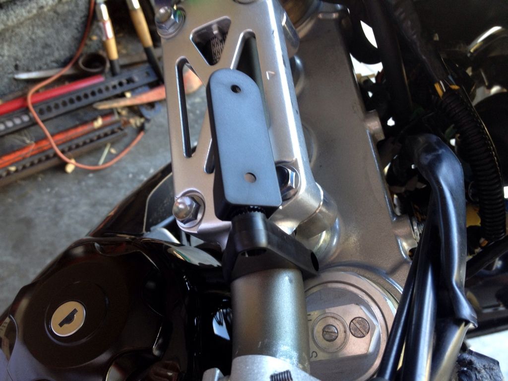

Mounting: The kit comes with a slightly chinsy but functional plastic mounting system.
I'm not posting pictures of how I did it, but if Dr. Seuss and Ruby Goldberg had a love child it would look like my mount...mega jinky.
Anyway, the reason I had to do that was because the biggest mounting ring (and the good folks at Trail Tech give ya two), won't go all the way around a set of Renthal Fat-Bars. It will snap on like it's going to, but when I put the screw in it was too short and wouldn't thread properly. Perhaps a longer screw would fix this. The kit also comes with a smaller clamp too, but that one was useless for my application. So, if you have fattie bars, be warned--ya may have to mod something(s).
In the long run I've got fantastic plans for a nice aluminum mount but we'll see what happens.

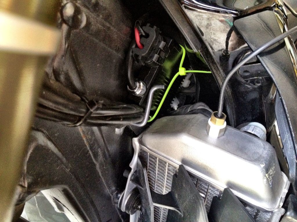

The temp sensor for the DRZ kit is a snap--it screws in to the top of the OEM radiator on the left side. Routed cable along the frame, easy and done.

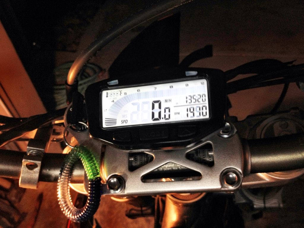

My program stats are as follows -- hope this info helps others doing the same mod.
Tire size entered - 1895mm (17", 120/70 Dunlop, and yes I measured thrice)
PPR - 1. (This was confirmed by several google searches)
High Temp Warning at 212F (Found on a TT forum from a DRZ owner with a Vapor)
Critical Temp Warning at 230F, which is the default setting (also found on the TT forum).
Shift light set at 8000 RPMs -- this from a review of the DRZ with mods, which states that the big power kick is from 5K to 8K.
Over-Rev light set at 9500 (though the rev-limiter kicks in at 10,500 from what I'm told. I figured safe>sorry).
