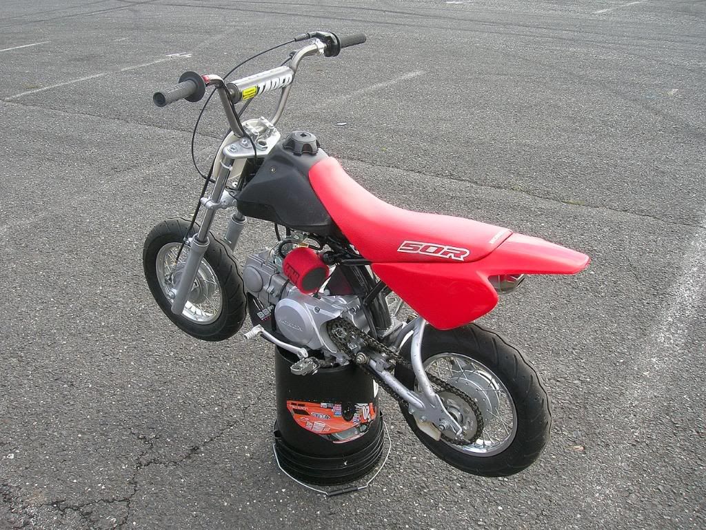

Here's an older pic of one of my bikes, it has XR70 front forks on it, and IRC MB38 scooter tires.
