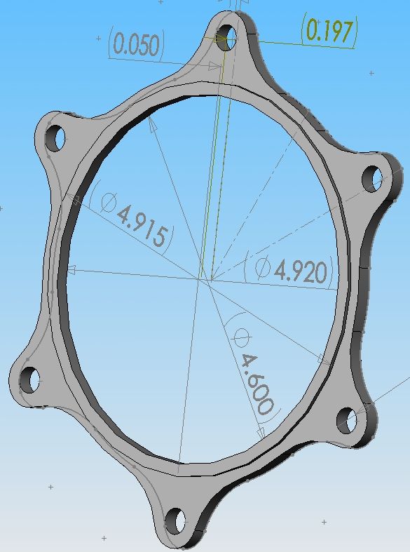

I'm building a 450x in a r chassis, currently aligning everything sprocket and wheel space wise. I've came up with a few good measurements and a rendering of a spacer.. I will be cutting the spacer in the next few days and would like to see if I should have a few made in order to help the ''crf'' owners out there with the chain rubbing, slapping and wheel alignment. Im not a fan of the wheel being offset so here is the opportunity to get a sprocket spacer.
let me know if some of you may be interested. thanks

Almost, .040 inch difference with the rear. What i did was flip the front along with a 1mm spacer on the counter, and then the spacer on the rear sprocket. Had to modify the chain slider and use a 150 tire on a 4.25 rim. Gives me almost 1/2 inch of space between the chain and tire which is normal and will prevent the chain from chewing the tire.
Most likely will add a custom chain slider to eliminate all slap. But the spacer plays the biggest role in this whole thing.
With the 100 and no spacer the chain rides on the tire or is about 1mm away from doing so. With the cost of the tires im not about to groove them which is completely counter productive and the wheel misalignment im not a fan of but will move the spoke a tad if i have to.
ill post pics when i finish mounting everything, possibly tomorrow

I ve done a ton of research about slider and ways to fix the issue on crfs. Its pretty much physically impossible for a supermoto setup to work flawless unless you misaligned the wheel and I believe most flip the front sprocket. In my opinion I much rather space the sprockets than play with hub offset.

402 Posts
before, chain is extremely close to riding on the tire
after, Much greater room between the tire and chain. The spacer made was pretty much the thickest we could
go before the sprocket hitting the swing arm.
The price was revised, It is now 100$ plus shipping. I make no profit, all goes to machine cost. I have 5 on hand
could be raw aluminum or anodized for extra cost. The more i ship the lower the price if the 5 sell great i will have more made.
lmk what you guys think
