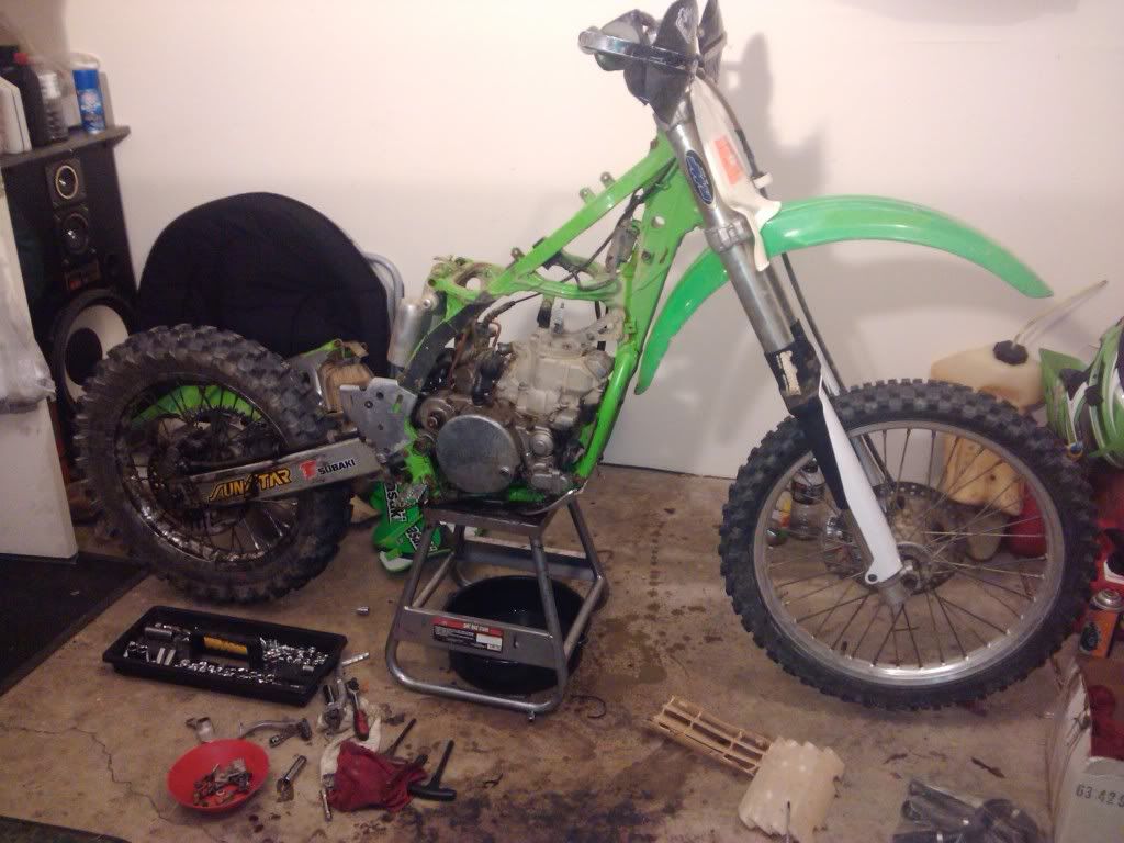

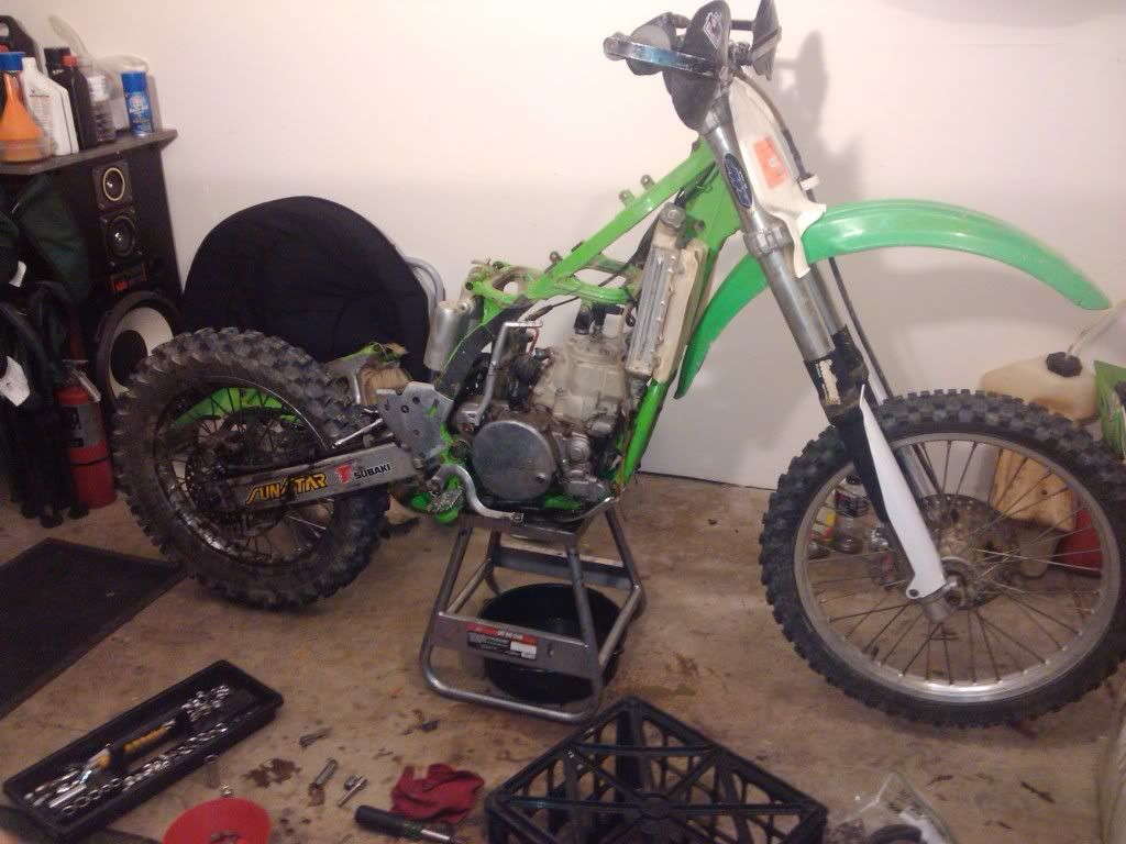

So here starts the tear down

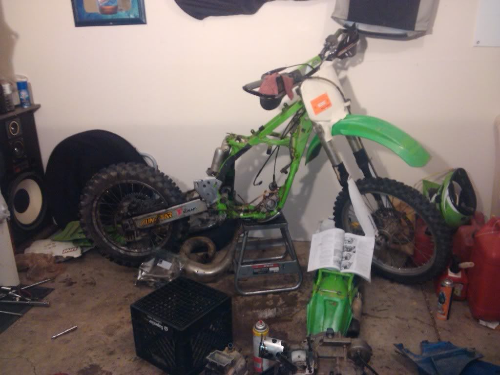

As Ugly as this tank is, it holds a TON of fuel for long trail days.
Unhooked the Carb boot, stinger junction and subframe.

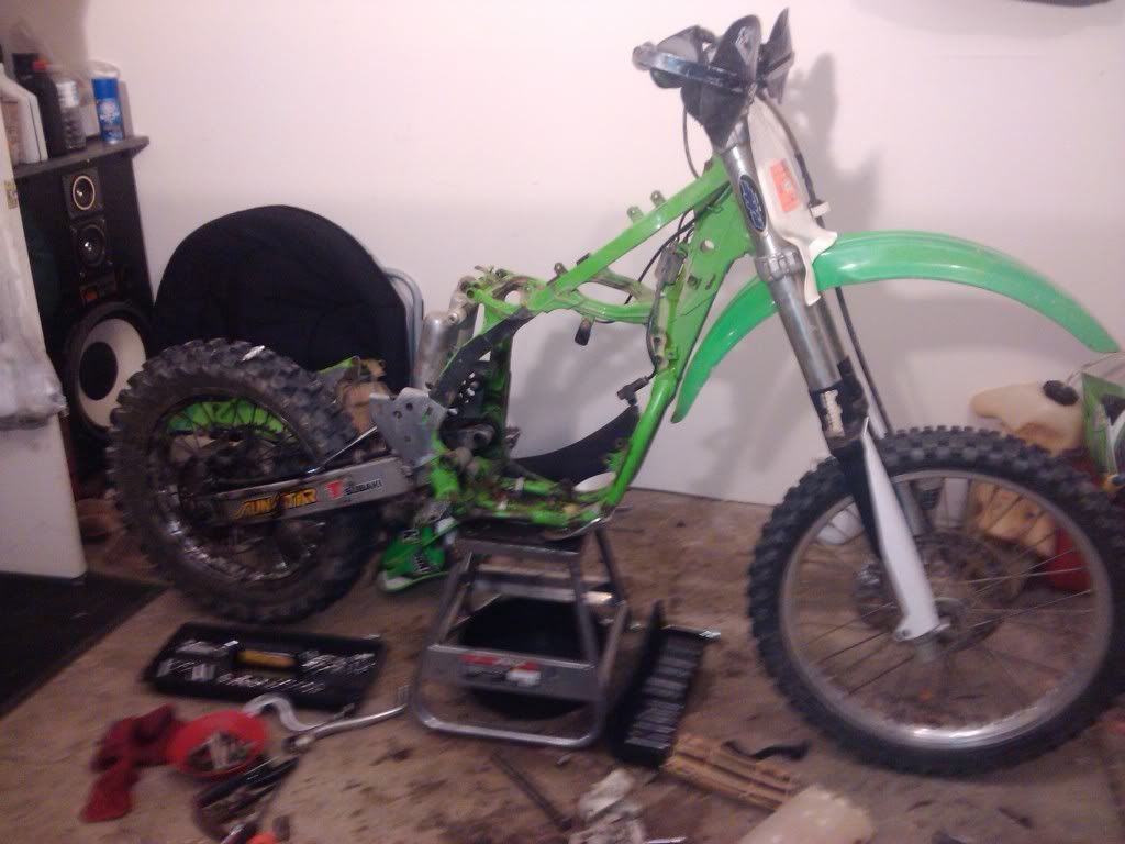

Removed the Gas tank and Radiators and Hoses.
Unhooked the Carb and harness.

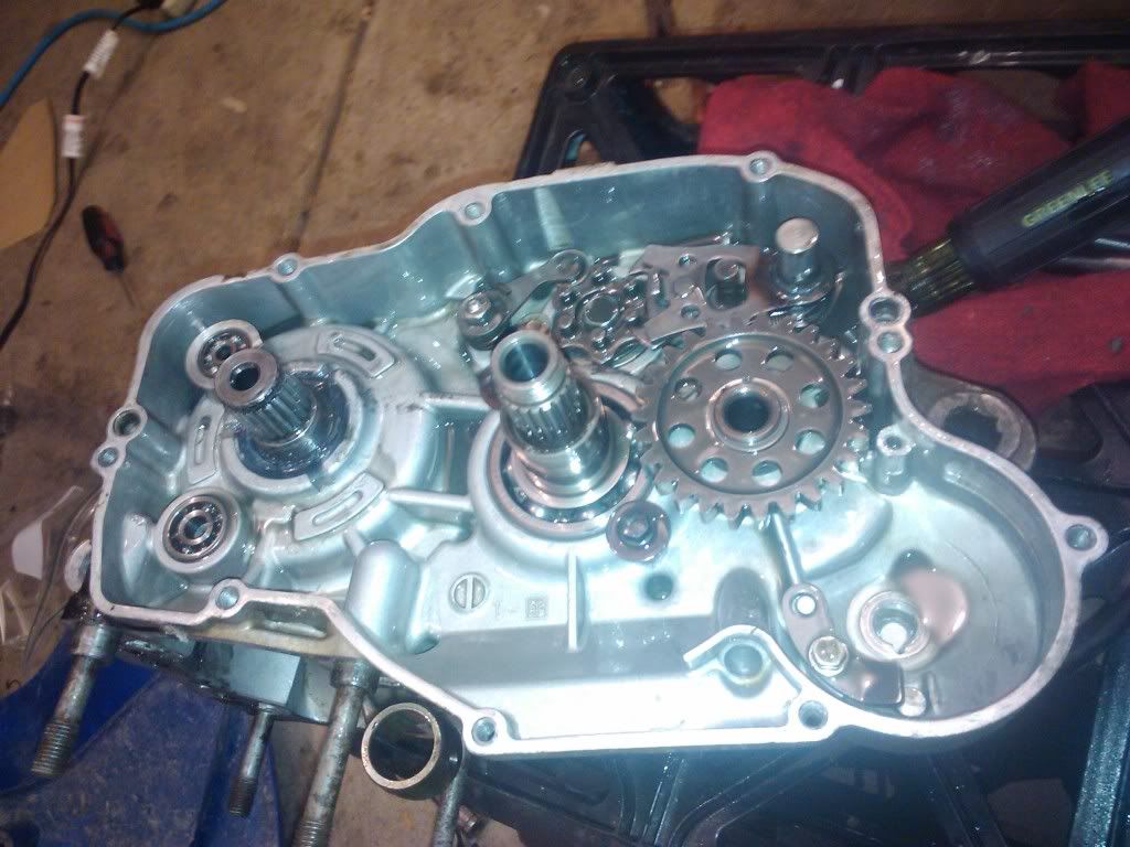

Upon Initial motor tear down we found some interesting things.
I don't have many pictures of them as they didn't come out well at such close views.
The case covers had miscellaneous hardware swapping (Think Phillips head screws instead of 8mm/10mm bolts), the clutch cover seal was ripped and RTV'd back together, and the worst of all, inside the clutch side, behind the crank shaft output spline, the "leaky" seal had been clear silicon bathtub caulked into place. The seal was leaking so badly that they cracked it open, saw that they needed to split the cases and glued it together and ran.
LEFT SIDE Shaft is Surrounded in CAULK!
Mechanically its fine, it just boggles my mind how people get that far and then quit instead of learning something and spending 100 bucks.
