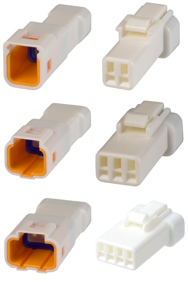

How you choose to connect your wires is up to you. My turn signals are OEM so they are plug and play. I purchased 2 and 3 Pin JST-JWPF Connectors from http://www.corsa-technic.com/category.php?category_id=115
Pins, and crimp tool. Crimping the pins on the wire was easy - getting them to lock into the connector was a PIA !!!!
With lots of patience and mutiple broken pins and connectors I finally got the pins to lock in. They sell a PIN insertion tool but I didn't want to spend $390.00 for it.
