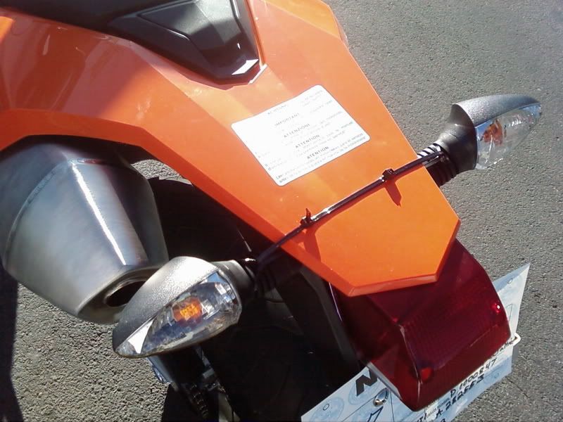

at the dealership I took few zip ties and zip tied turn signals together. The tighter you do it, the higher the turn signals will bend.
This of course is just temporary till KTM steps up and comes out with a permanent solution.

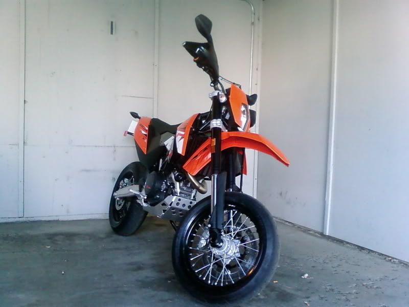

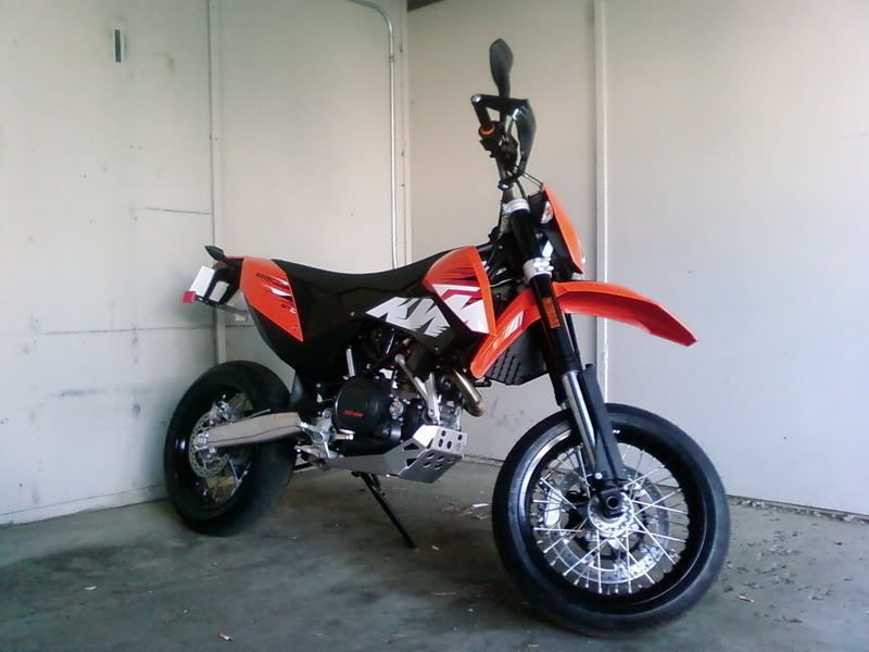

and some misc pics cause it just looks so good
metal skid plate

so our service manager was on the phone with ktm today and they recommended getting zeta brand turn signals. i guess they will be more out of the way and won't burn up. thats is the answer from ktm so far. lol
mine has started to melt but hasn't gotten any worse today.

70 miles on my bike and this is the turnsignal.
A shame really because they are the nicest looking stock blinkers I have seen on a stock bike.
We really did get jacked around on the tail light as well as the Euro one looks SO much better.

I wonder if getting rid of the stock muffler/cat will cool the exhaust flow. or maybe the aftermarket can is slightly lower or points lower.

I know there is a requirement as to how many inches the turn signals have to be apart BUT IMO putting on signals on short stalks could also fix the melting issue
well I guess the zipties helped a little cause I also put 70 miles on the bike and the turn signal looks ok

i think the way to go is use some crotch rocket turn signals, but that made that small piece coming out of the fender, so would have to fab a bracket, which i may do
anyone seen these 'zeta' turn signals? couldn't find them on the net?

HOLY SHIT!!! i put heat tape on the back of mine so the only problem i have is a slight little bit of melting going on on the underside of the actual lens. now that is crazy. bring that bike to the dealer and have them send a pic to ktm! i had no idea it could be that bad. glad i put heat tape on mine before i even started the engine.
569 Posts
they had the same problem on 525's, etc awhile back
i sent the pic to my friend who works for KTM, but KTM Austria is a whole other beast and don't think we'll get much out of them, I ordered some new, short turn signals, will post them up when i get them and get them installed...

This is just bad....It's almost as bad ad the Aprilia guys who put the GPR exhaust on their bikes, except you guys are stock!:poo: That's absolute bullshit, I'd be going back to the dealer repeatedly. No, it's not the dealers fault, however it is their responsibility to deal with the manufacturers faults until they're given a fix. I'm surprised that a completely stock exhaust that's not modified does this.

The blinker problem might be worse here because it's 101 degrees everyday lately.

I just spoke with my KTM dealer in Massachusetts and he indicated that KTM is aware of this issue and is working on a solution. I mentioned the European tail section seems to make the most sense but according to my dealer, there could be some Department of Transportation requirements in the United States that would make this impossible.
I suspect that we'll be hearing something soon. In the meantime it appears the heat tape/deflector is the most viable solution. I just ordered the Ankrapovic slip on and may have it this week. I'm just sure if this slip on will be a greater distance from the turn signal.
