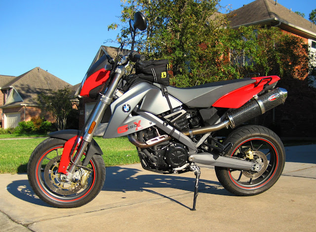

    very nice exhaust...i like the carbon fibre finish a lot
    but i think you will need a heatshield for the midpipe...

    Absolutely beautiful

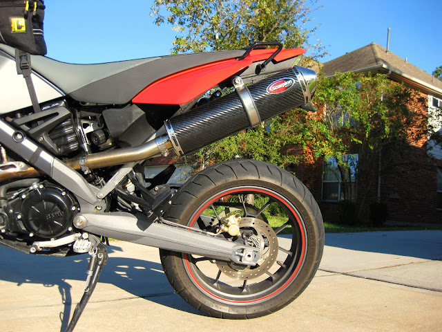

    So it took me a while to get the mount done correctly. If any of you guys have noticed, the stock exhaust has a collar insert that helps maintain a seal whenever the hose clamp is tightened. The Scorpion mid-pipe to header connection could really use one of those. I think the collar is a sort of steel mesh ring layered in graphite. Either way, the mid-pipe to header connection was bleeding exuast pretty bad until I finally got it sealed up by widening the midpipe a little and sliding it further down the header.
    Final product:
    A little closer up:

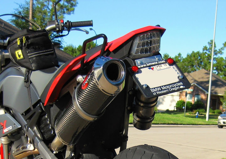

    I also finally got around to doing a much needed tail chop. It's not quite finished but once I paint the aluminum bracket black and add some turn signals alongslide the rear sub-frame it should look pretty good.
    Oh and one more thing.... passed the 3500 mile mark today and the bike still runs a smooth as the day I got it. No mechanical issues what so ever.

    I'm pretty sure there is little or no difference because it is not a "true" carbon canister. It is still a steel muffler. It's just wrapped in carbon for the look.
