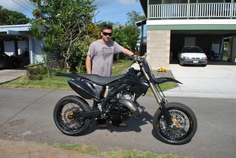

    Here is satans Supermoto. Plated too

    haha thats my bike on craigslist.
