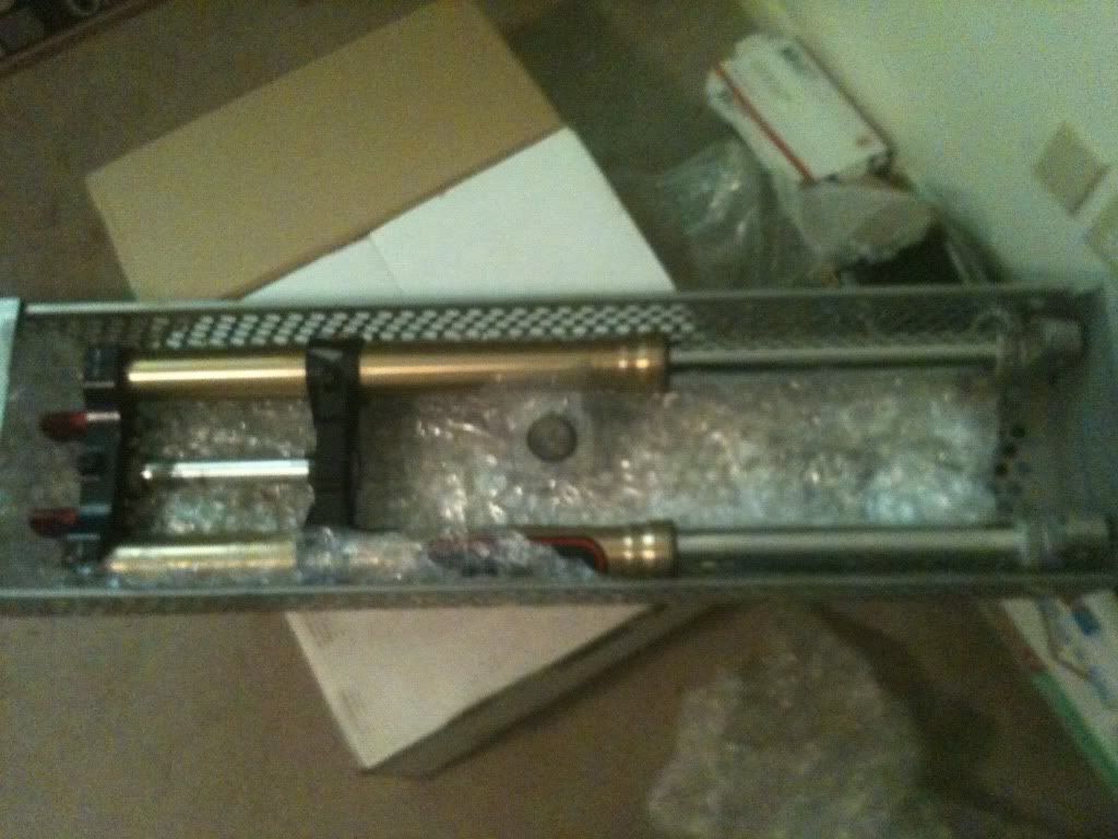

    IT starts I have already procured the USD crf450r forks and tag triples w/ conversion bearing to make the triples plug and play to the xrr head.

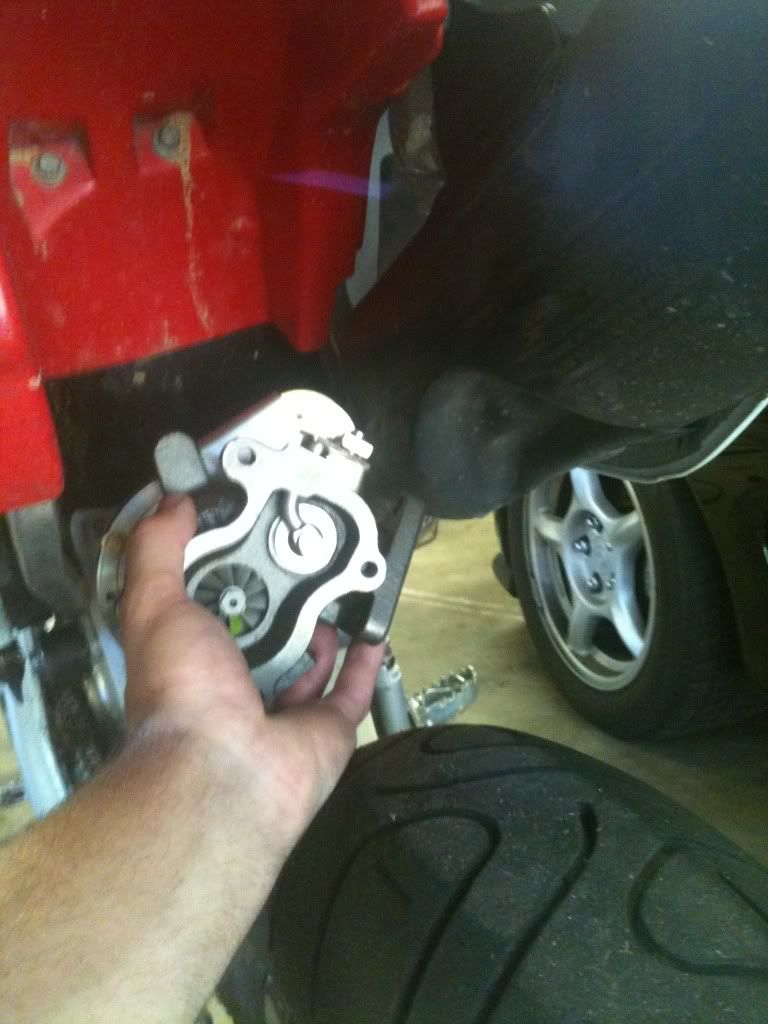

    I have also procured the gt1544 to start fabing for that little beauty. I think i will be installing it towards the rear of the bike right at the beginning of the muffler as there is enough room and moves the weight farther back as the BRP is a bit nose heavy as it is.
    my first thoughts were to mount it as close to the head as possible for ease but the turbo i have still runs the gt12 inlet flange and not the t2 flange which would be perfect to fab a manifold for 1.5" runners right down its throat next to the left radiator. but alas that may end up in BRP-T 2.0

    Heres a few of the parts i got in theres more and the rest of these all over right now but heres the major ones.
    And my new mascot for the BRP....
    Here is the QTM cast radial brembo with bracket.
    And heres the beautiful machining they do to make the caliper fit.... but its not enough for spoked rims so i will have to do a bit more.

    Default
    Quote Originally Posted by proz07 View Post
    z
    I have the same caliper... I was going to machine alittle more also, but when I removed the pistons to check the thickness it was already pretty thin so I couldnt use the caliper... so, I would say check it before you chop on it...
  39. #37
    Join Date
    May 2007
    Posts
    1,478
    Default
    Quote Originally Posted by metalworxs View Post
    Man im starting to think the same thing right now.... others have used it shaving it down with good results on spoke type rims... i can say QTM said it WONT work on spokes so i quess it might be a 300$ i told ya so. I really dont want to spend an aditional 2-300$ on a billet caliper that will work if i can sell this one. I mean i really dont need anything more than this its just a street bike.
    I plan on pulling the pistons and checking as well. How much thickness did you have left? Also any suggetions on getting the pistons out short of adding fluid.... maybe a shot of compressed air?
    z
    z
    I never machined it more. I thought it was too thin from them milling it... I just used a little shot of air to get the pistons out...
    OK since we are talking about it I temp threw it together so everything is snugged down. Looks like it actually will work however with just a touch more shaving in the area between the pistons where its closest to the spokes, maybe 1/16" and it should be money. that's the thicker part of the casting so i have a bit more material to play with i believe there is enough material as long as I do it slow and stead should turn out perfect.
    z
    z
    right on, it was way off on my wheel, I hope it works for ya

    being that issue looks like its fixable.... I also got a chance to play with the rear wheel as well. It's a wide tire thats for sure but it will fit after i adjust the spokes a little. Fasterusa said they dished the rims so they dont have chain rub. Well ya they do but not so it will fit in the swingarm as well. it probably wouldnt be an issue with like a 4.25 but with the 5" that im using and the super wide BT-016 160 its rather snug and dished this way rubs the swingarm but plenty of space on the chain side. Sooo i will adjust the spokes back the other way so it will fit in the swingarm and just clear the chain. its going to be tight but should look awesome and perform wiht the HP goals on this bike.

    So here's the USD fork conversion with a fleabay 06 CRF fork and triple setup i picked up and the conversion is accomplished via an evolution suspension conversion bearing as seen in the following pic. It comes with as far as i can tell the machined race a custom smaller bearing, 2 different sized washers, and a dust seal.
    so near as i could tell with what worked and didnt the kit comes with extra as it is used for the XRL usd conversion as well you just need two of them one top and one bottom. so the dust seal is for the bottom i reused the CRF top dust seal. And i only used the thicker washer on top of the bearing to get the space right to use the dust seal, i can only assume the other washer and dust seal are to do the XRL lower bearing conversion.
    the parts not used
    race installed
    bearing then thick washer, notice it gives enough room for the dust seal to actually be useful.
    now the seal and lower triple nut.
    and then upper triple clamp and forks.
    This is the simplest form of this conversion i think as all it is is swapping out one bearing unless you go anal and do every bearing and new parts but I dont buy new unless its toast. So cost of the CRF triples and forks you source then 60$ for the conversion bearing 120$ if doing an XRL. pretty cheap if you ask me.
